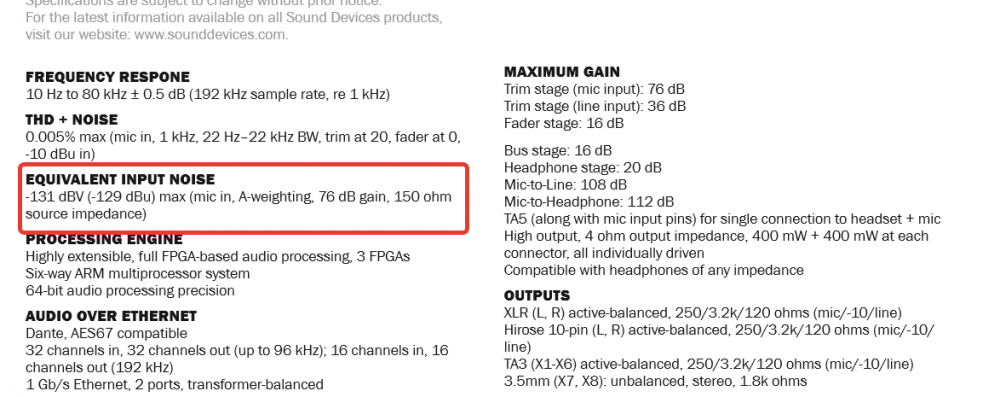

INARI Posted April 9, 2019 Report Posted April 9, 2019 On 4/5/2019 at 12:25 AM, manuelchk said: What preamps? Not Kashmir right? looks like kashmir. same gain same THD. However, it has 1 dBu less noise. please see user guide. Quote
Vincent R. Posted April 9, 2019 Report Posted April 9, 2019 14 minutes ago, INARI said: However, it has 1 dBu less noise. So, not Kashmir. Quote
borjam Posted April 9, 2019 Report Posted April 9, 2019 It doesn't look like the Kashmir preamp at all. Remember that the Scorpio offers adjustable limiters while the MixPres have a fixed time constant and threshold level. Quote
Jim Feeley Posted April 9, 2019 Report Posted April 9, 2019 I would --guess-- the Scorpio doesn't have Kashmir preamps. I'd think SD would say if they were, and I also think of the Scorpio as being a much higher-end device than those in the modern MixPre line. But I'd also guess the Scorpio's preamps are impressive. Just a guess at this point, though. Quote
chrismedr Posted April 9, 2019 Report Posted April 9, 2019 Actually I'm pretty sure Paul from SD himself said somewhere (probably even in this thread) they are new preamps (their best to date ; ) edit: found it: On 4/4/2019 at 5:29 PM, Paul Isaacs said: They are Scorpio preamps. Lowest noise we've made to date. Quote

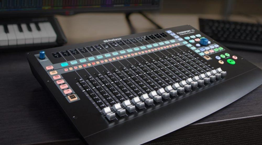

Vincent R. Posted April 10, 2019 Report Posted April 10, 2019 I kinda agree with the critique on the size of the M+. A CL12 was about right for a rack mount based cart, which is not unlikely you have, for higher track count recordings/jobs. And the M+ is 8 track so if you you need a tad bit more you are at 16, over the width of a rack. Whilst the other way around, 19 inch width is ok to have like 12 to 16 faders easily. Loads of smaller PA boards out there that can cramp a reasonable amount of numbers on that space. This Presonus one is slightly over 19 inch, for example. Quote

Mirror Posted April 10, 2019 Report Posted April 10, 2019 16 hours ago, Constantin said: How about one behind the other? Slightly stacked? I'd prefer, as I imagine most production sound mixers would, that SD makes a dedicated control surface to fit the needs of production sound mixers and not let their customer base rely on equipment used by garage band flunkies. I want buttons on the board that are dedicated to the needs of production sound mixers. I really like the CL-12 other than the omission of trim knobs for each individual channel. Make that and I'll buy a Scorpio. ---------------------------------------------------------------------------------------------------------------- 16 hours ago, Vincent R. said: I kinda agree with the critique on the size of the M+. A CL12 was about right for a rack mount based cart, which is not unlikely you have, for higher track count recordings/jobs. And the M+ is 8 track so if you you need a tad bit more you are at 16, over the width of a rack. Whilst the other way around, 19 inch width is ok to have like 12 to 16 faders easily. Loads of smaller PA boards out there that can cramp a reasonable amount of numbers on that space. This Presonus one is slightly over 19 inch, for example. Unfortunately, no dedicated trim knobs for each individual channel. Quote
Vincent R. Posted April 10, 2019 Report Posted April 10, 2019 3 minutes ago, Mirror said: Unfortunately, no dedicated trim knobs for each individual channel. oh i know, the picture was for illustration purposes, to show a higher fader count in still a denser but reasonable size. Quote
